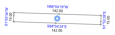

  3. After entering your closed loop parcel traverse, click Create Seeds in the Construct group on the Parcel Record Workflows tab to create a seed for the parcel traverse.
    Parcel traverse with seed
    After creating the parcel traverse, create a seed for the parcel.

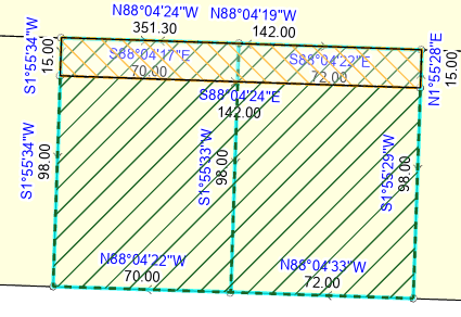

  9. Select the target parcels you want to clip and use to create remainder parcels.
    Clip target parcels
    Select the target parcels that will be clipped by the new parcel.
  10. Choose the Discard (Remainder) option in the Clip pane, and click Clip to clip and create remainder parcels.
