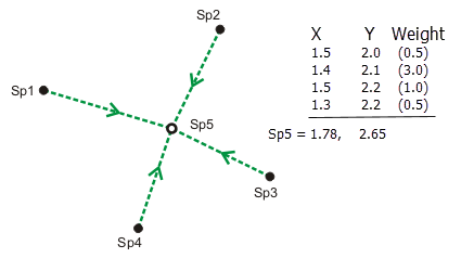

The coordinates of a new point can be uniquely computed by a bearing and a distance from an existing point. However, relying only on the results of a single set of coordinates is risky, since there is no way to tell whether the measurements defining those coordinates are correct. Coordinates computed from measurements from other existing points can be compared with the coordinates computed by the first set of measurements. Generally, the more measurements defining a single point, the more reliable its coordinates are and the more confidence there is in detecting mistake measurements. These additional measurements are called redundant measurements.
All measurements contain some degree of error. Redundant measurements will compute slightly different coordinates for the same point. Since there can only be one coordinate location for a point, best-estimate coordinates for the point can be derived by computing a weighted average of the redundant measurements, with each weight defined by the measurement accuracy. The higher the accuracy of the measurement, the higher its weight and the more influence it will have in computing the best-estimate coordinates of the point.
Weighted measurements
The coordinates for point Sp5 are computed using a weighted average.
