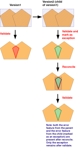

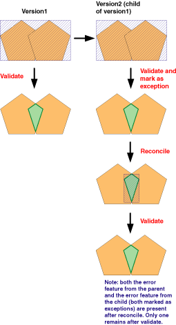

There are cases in which the same error can be created in both versions by validating a dirty area that existed in the parent (default) version when the child version was created. If this error is marked as an exception in either the parent (default) or child version, the reconcile results in duplicate error features. In these cases, the error features are covered by a dirty area and reduced to a single error or exception when the dirty area is validated. This is illustrated in the two examples below.
Example 9
Example 9
Example 10
Example 10
