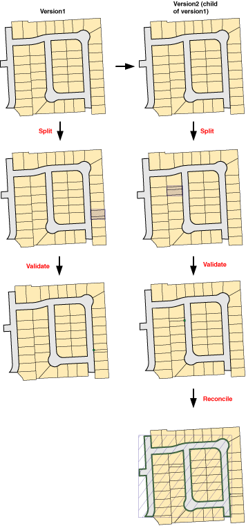

Example 1—Splitting two adjacent polygons in each version
Polygons that share edges in a topology in the parent (default) version are inherited by the child version. In this scenario, a polygon is split in the parent (default) version, an adjacent polygon is split in the child version, and the dirty areas are validated. Splitting the polygons deletes the original features and replaces each of them with two new polygon features. When the versions are reconciled, both original polygons are reported as update-delete conflicts. In other words, the feature that was deleted in the parent (default) version was updated by the clustering process when the child version was validated, and the feature that was deleted in the child version was updated by the clustering process in the parent (default) version.
Example 1 illustrates splitting two adjacent polygons in each version.
Example 2—Splitting polygons that share edges with a large right-of-way polygon
This illustrates another example in which the introduction of vertices by the validate process can introduce conflicts in a land records database. In this case, the parcel polygons that are split share edges with a very large right-of-way polygon.
Example 2 illustrates splitting polygons that share edges with a large right-of-way polygon.
