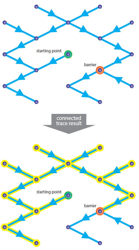

Connected trace
A connected trace begins at one or more starting points and spans outward along connected features. A trace traveling along a path stops when either a barrier is encountered or there are no more connected features (the end of a path). This type of trace is useful for confirming that newly edited features are connected as expected.
Example of a connected trace
This type of trace travels the network based only on connectivity. To control the traversability of this type of trace, you must configure the Trace tool manually. Consider an example using the NHDFlowlines feature class from the National Hydrography Dataset; with a network attribute set on the FCode field, you could configure a condition barrier to stop the trace if an artificial path is encountered (FCode = 55800). Output conditions can also be configured to control the results of a trace. For example, to identify connected streams and rivers in the dataset, you could run a connected trace but return only edges with FCodes between 45999 and 46008.

See Find connected features for more details.

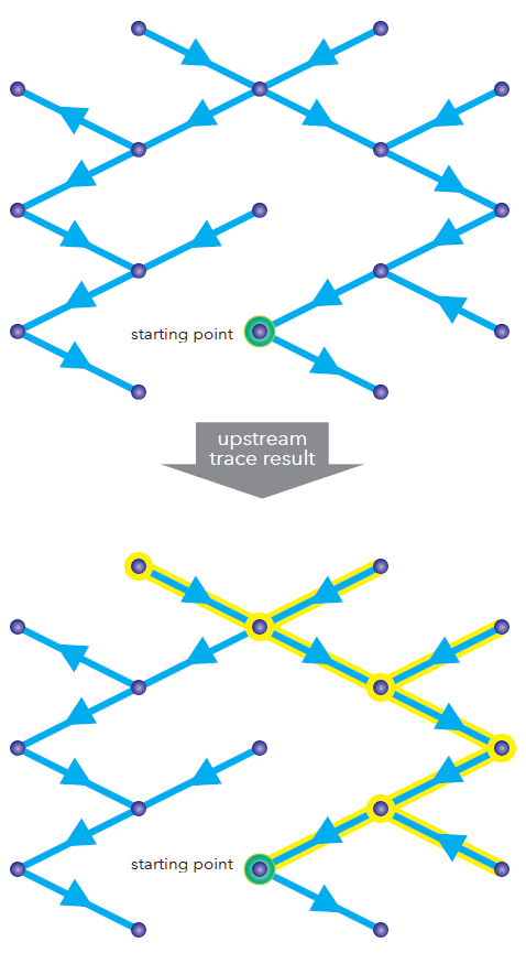

Upstream trace
Upstream traces travel upstream, away from starting points placed on edge or point features.
To perform an upstream trace, one or more starting points must exist. If a barrier is encountered or there are no more connected or traversable features, the trace stops. Features between the starting points and upstream end locations are returned. If the starting point originates within a loop, trace results return all features in the loop.

Configure the Trace tool parameters to modify an upstream or downstream trace.
See Find upstream and downstream features for more details.

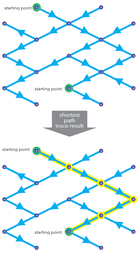

Shortest path trace
Identify the shortest path between two starting points using a trace. The shortest path is calculated using a numeric network attribute such as shape length. Cost- and distance-based paths can both be achieved using this type of trace.
To incorporate traversability into this type of trace, the Trace tool parameters can be explicitly set, making it an advanced shortest path trace. Advanced shortest path traces allow you to find the shortest path between two points in a storm water network along channels 54 inches and larger, for example.
Example of a shortest path trace
Learn more about how to discover the shortest path between two points in a network
