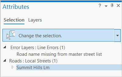

  6. Click Summit Hills Lm to select it.
    The Summit Hills Lm layer selected in the Attributes pane

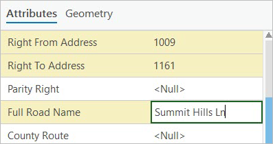

  7. In the attributes, scroll to Full Road Name and change Lm to Ln, and press Enter.
    Corrected road name

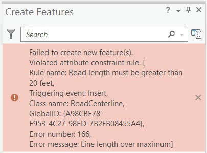

  3. Draw a small road in the map and double-click your mouse to place the road feature.
    A drawn road feature that is less than 20 feet
    An error message appears in the Create Features pane that lists the requirements of the rule and informs you that the edit could not be completed.
    A constraint rule error message describing an invalid feature
