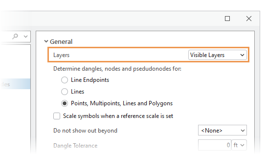

Choose the layer type and feature mode
The layer setting determines the type of layer for which symbols are displayed, while the feature mode defines the feature types where dangle, node, and pseudonode symbols are shown.
To change the layer and feature mode settings, complete the following steps:
  1. On the Edit ribbon tab, click Settings in the Manage Edits group.
    Alternatively, hover over the Vertices and Nodes button on the status bar at the bottom of the active map and click Vertices and Nodes Settings .
    Vertices and Nodes
    The Editor Settings dialog box appears.
  2. Click the Vertices and Nodes side tab and expand the General section.
  3. Click the Layers drop-down arrow and choose the layer type for which symbols are displayed.
    You can render vertices and nodes on editable, visible, or snappable layers.
    Layer settings
  4. Choose a feature mode:
    Refer to the symbology section below for details on how each symbol type represents specific feature connections.

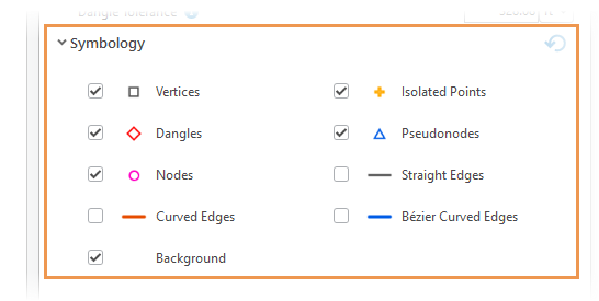

Configure symbology
The symbology options allow you to choose what is symbolized when Vertices and Nodes is enabled on the status bar at the bottom of the active map.
To configure symbology, complete the following steps:
  2. Click the Vertices and Nodes side tab and expand Symbology.
    Symbology
  3. Check or uncheck the Dangles, Nodes, and Pseudonodes check boxes.
    The nodal symbols identify the spatial relationships between features, allowing you to visually determine how they connect.
    Tip:
    Verify that the feature mode setting properly displays these symbols for the intended feature types.
    Dangles
    A dangle symbol appears when the endpoint of a line feature does not connect, within the dangle tolerance, to a point feature or the edge of a line or polygon feature. Dangles are often referred to as undershoots or overshoots.
    Note:
    • If the dangle tolerance is set to zero (0), dangles are shown for all unconnected line feature endpoints.
    • If a dangle falls outside the dangle tolerance and Vertices are enabled, a vertex symbol is shown.
    Nodes
    A node symbol appears where two or more edges meet or intersect, and where three or more endpoints of different line features connect. Nodes at edge intersections imply a topological connection between the edges.
    Pseudonodes
    A pseudonode symbol appears where the endpoints of two different line features meet. Pseudonodes are typically used to highlight locations where two features can be merged.
  4. Check or uncheck Vertices, Isolated Points, Background, and the edge symbol check boxes.
    The following symbols identify specific feature geometry, allowing you to distinguish them from the nodal elements.
    Vertices
    A vertex symbol appears at each vertex of a line or polygon feature that isn’t a nodal element. It also appears where a point feature connects to the edge of a line or polygon.
    Isolated Points
    An isolated point symbol appears for a point feature that isn't connected to any other features.
    Background
    The background is drawn between the vertices and node symbols and the visible feature layers within the view's extent. It provides color contrast to enhance symbol visibility and improve readability.
    Straight Edges
    The Straight Edges symbol highlights straight segments of a line or polygon feature.
    Note:
    If Curved Edges or Bezier Curved Edges are unchecked, segments that are true curves for those settings are also highlighted using this symbol.
    Curved Edges
    The Curved Edges symbol highlights circular features and circular arc segments of a line or polygon feature.
    Bezier Curved Edges
    The Bezier Curved Edges symbol highlights Bezier curve segments of a line or a polygon feature.
  5. To customize the color or other formatting for a symbol, click the symbol name and adjust the controls that appear below the symbol check boxes.
    Formatting options
    Note:
    Formatting options vary depending on the selected symbol.
  6. To reset all Symbology settings to their default values, click Reset to default .
