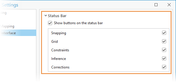

  2. Click the User Interface side tab and expand Status Bar.
    Status Bar settings
  3. Check the Show buttons on the status bar check box.
    To hide the enabled buttons, uncheck this setting.
  4. Check the check box for each drawing aid button you want to show on the status bar.
    To hide a button, uncheck this setting.
