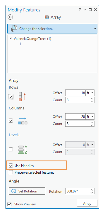

  5. In the tool pane, check or uncheck the Use Handles check box.
    Use Handles
    Checked
    Turn on axis handles.
    • Dragging a handle updates the distance value in the Offset text box for a column, row, or level.
    • Enter a value greater than 1 in the Count text box to show the axis handles.
    Unchecked
    Turn off axis handles.

  7. Check the Rows check box to create rows.
    Offset
    Enter the offset distance between each row, or drag the axis arrow handle to update the value.
    • A negative value adds rows in the opposite direction.
    • Offset values for rows are measured from the bottom leading edge of the selected feature.
    Count
    Enter the number of features to create at the specified offset.
  8. Check the Columns check box to create columns.
    Offset
    • Offset values for columns are measured from the bottom leading edge of the selected feature.
    Count
  9. Check the Levels check box to create vertical levels.
    This option is available only when you select a z-aware feature.
    Offset
    • Offset values for levels are measured from the bottom leading edge of the selected feature.
    Count

  11. Set the angle at which the features are copied using one of the following methods:
    Click the Rotation text box.
    Enter the angle. Alternatively, click the arrows to increase or decrease the number.
    Click Set Rotate .
    Move the pointer, and click the map to set the angle.
    On the status bar at the bottom of the active map or scene, click the Grid button .
    Use the grid to set the rotation angle and disable the angle settings in the tool pane.
  12. Click Array.
