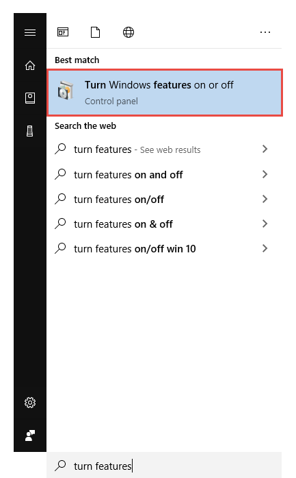

  1. In the Windows task bar, click the Search command, and type turn features.
  2. Click Turn Windows features on or off.

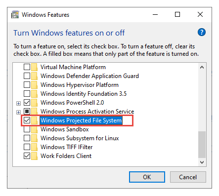

  3. Check Windows Projected File System.
  4. Click OK.

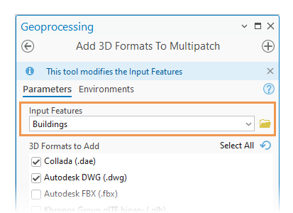

  3. If the 3D format does not appear in theWindows 3D Objects folder, add it with the Add 3D Formats To Multipatch tool.
    1. On the Analysis tab, in the Geoprocessing group, click Tools .
    2. In the search box, type add 3d and click Add 3D Formats To Multipatch.
    3. Click the Input Feature drop-down arrow and choose the multipatch feature layer you want to replicate in the Windows folder.
      Tip:
      The Windows 3D Objects folder is typically located on the C drive, for example: C:\Users\<username>\3D Objects. On Windows 10, you can click This PC in File Explorer. If this folder doesn’t exist on Windows 11, manually create it in this location.
    4. In the 3D Formats to Add section, check the formats you are editing with the third-party application.
    5. Click Run .
