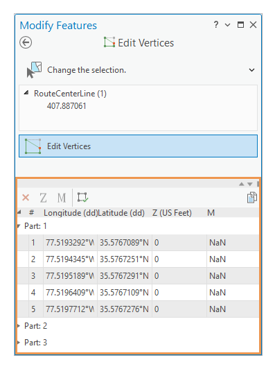

To edit z-values in the geometry properties table, complete the following steps:
  1. Add your data and configure settings for editing.
    Confirm that the feature layer you are editing is editable, the coordinate system assigned to the active map is suitable for the type of edits you're performing, and snapping is configured to help you work efficiently and accurately.
  2. On the ribbon, click the Edit tab. In the Features group, click Modify .
  3. Click Edit Vertices in the Modify Features pane.
    To find the tool, expand Reshape, or type Vertices in the Search text box.
  4. Click the Change the selection tool in the tool pane and select a polyline or polygon feature.
    If you select more than one feature, reselect the feature. Alternatively, click the feature in the pane selection view to flash it in the map, right-click and click Only Select This .
    Note:
    If Map Topology is enabled, click the Features tab.
    The Features and Edges tabs are not required to complete this workflow. These tabs are available only when map topology or a geodatabase topology is enabled so that you can switch between editing feature vertices and topological edges and nodes.
    The selected feature appears highlighted in the map with vertex handles. By default, project settings symbolize the first vertex green and the last vertex red.
  5. Click the z-value attribute field in the geometry properties table, type the z-value, and press the Enter key.
    To select and apply the same z-value to multiple vertices, press the Ctrl key, and select the vertex rows in the geometry table. Click Update Z Values on the toolbar, type the value in the dialog box, and press the Enter key.
    Z Value
    Alternatively, right-click the vertex in the map, click Move or Move To , type the z-value in the dialog box, and press the Enter key.
  6. To finish the feature, right-click and click Finish , or press the F2 key.
