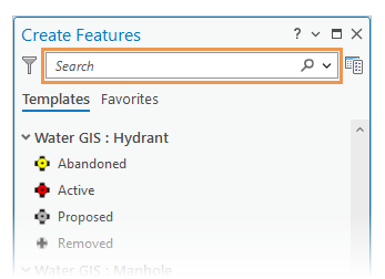

Filter or search in the Create Features pane
To filter or search editing templates in the Create Features pane, complete the following steps:
  1. On the Edit ribbon tab, click Create in the Features group.
    The Create Features pane appears.
  2. To search editing template metadata, click and type the keyword in the Search box .
    To clear the search box, click Delete or press the Backspace key.
    Create Features Search box
    Tip:
    To restore a recent search word, click the search drop-down arrow. Search history is available until you close the project or clear the history.
    Editing templates containing the word in the search box appear in the pane.
