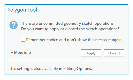

Configure the active tool dialog box for uncommitted edits
The active tool dialog box requires the results of an active sketch tool to be applied or discarded if another sketch tool is activated before a sketch is finished. It can be configured to always appear, or never appear and silently apply or discard the results of the active sketch tool.
To configure the active tool dialog box option, complete the following steps:
  1. Click the Options dialog box launcher on the ribbon Edit tab, in the Manage Edits group.
    The Options dialog box appears.
  2. Click the Editing side tab, expand General, and scroll to the Geometry section.
  3. In the Uncommitted geometry edits section, choose one of the following settings:
    • Always prompt—Always show the dialog box and require uncommitted feature geometry to be applied or discarded when using tools that draw geometry. Examples include feature construction tools and tools that reshape or continue editing features.
    • Apply—Never show the dialog box and automatically apply uncommitted feature geometry.
    • Discard—Never show the dialog box and automatically discard uncommitted feature geometry.
  4. Click OK.
    Your settings are saved and the dialog box closes.
Note:
To turn off this option on the dialog box, check the Remember choice and don't show this message again check box.
Uncommitted geometry warning
