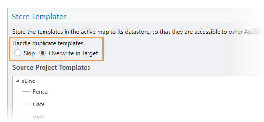

  6. For Handle duplicate templates, choose Skip or Overwrite in Target.
    These options are available only if matching template names exist.
    Skip
    Copy editing templates with unique names to the database, and do not replace templates with matching names.
    Overwrite in Target
    Copy editing templates with unique names to the database, and replace templates with matching names.
    Handle duplicate templates option
