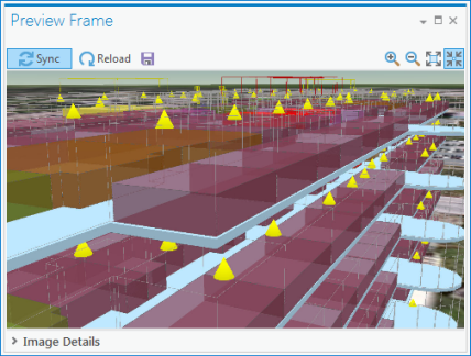

The Preview Frame window for animations

Preview Frame options
The controls on the Preview Frame window are as follows:
  • Sync Sync——Sync is on by default so that the Preview Frame contents will update automatically. Click Sync to disable automatic updating of the image.
  • Reload Reload Preview—Click Reload to manually force a redraw of the preview image.
  • Save Save—Click Save to save a copy of the image to disk.
  • Image Details—Expand the Image Details section at the bottom of the window to see additional details about the animation frame.
