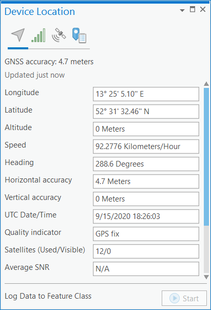

GNSS details
The Details tab displays location and position fix information about the connected GNSS device. These values cannot be edited. The current measure of accuracy and the amount of time that has passed since the last update displays at the top of the pane. In addition to the device's current latitude, longitude, and altitude, the pane shows speed, heading, and accuracy.
Fix details—such as the quality indicator display, number of satellites visible and used, and the average signal-to-noise ratio (SNR)—update if the status of the connection changes.
The Dilution Precision subsection displays the horizontal dilution of precision (HDOP) and vertical dilution of precision (VDOP) values. This is an effect of the current position's satellite distribution. The positional dilution of precision (PDOP) value is a combination of these two values.
All information displayed in the pane updates periodically to reflect any changes from the device.
