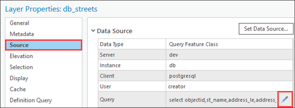

  3. Click the Source tab on the Layer Properties dialog box.
    The Data Source table contains a property named Query, which displays the current SQL query for the layer.
  4. Click the Edit Query button.
    The Layer Properties dialog box with the Source tab and the Edit Query button
    The Edit Query Layer dialog box appears.
