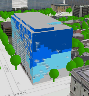

When you work with 3D layers, it's possible that some features will compete for the same space in the scene. This can result in flashing anomalies. To resolve this drawing issue, often referred to as z-fighting, you can set the depth priority of a layer to force it to draw on top. For example, if you want a textured multipatch layer to draw in front of another multipatch layer that competes for the same space, set the depth priority of the textured multipatch layer higher than the other.

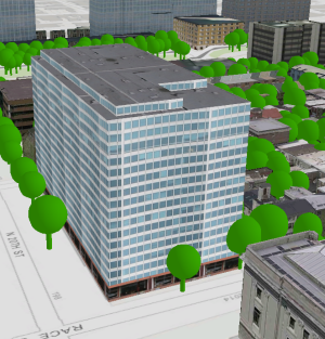

Features from two 3D layers with z-fighting Features from two 3D layers with depth priority set
