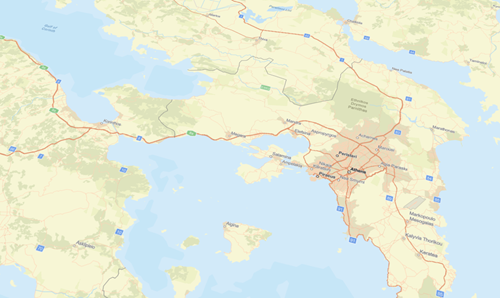

A 3D view of the Streets basemap over Athens, Greece
A sample basemap over Athens, Greece, is shown.

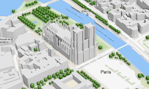

As 2D basemaps are designed for maps, 3D basemaps are designed for local and global scenes. They include scene layers such as buildings and trees.
A 3D basemap of Paris, France
A sample 3D basemap shows OpenStreetMap buildings and trees.
