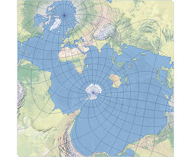

A beneficial property of this projection is that it can be tessellated or mosaicked. This projection or a similar projection was used by Athelstan Spilhaus in 1979, with the help of Robert Hanson and Ervin Schmid, from the National Geodetic Survey, for his world ocean map (see the second image, below).

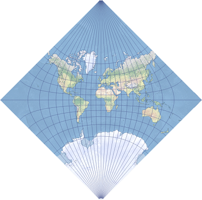

An example of the Adams square II map projection
The Adams square II projection in normal aspect.
An example of the Adams square II map projection with the Spilhaus configuration
The Adams square II projection with Spilhaus's configuration.

In an equatorial aspect, the equator and central meridian are projected as straight lines forming diagonals of the square. The antimeridian is projected as a straight line bent at the equator forming the square outline of the map. Other meridians are complex curves. The parallels are complex curves, unequally spaced along the central meridian and concave toward the nearest pole. Their spacing grows with the distance from the equator. Both poles project as a point in opposite corners of the square. The graticule is symmetric across the equator and the central meridian.
