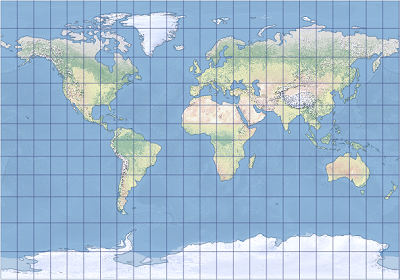

An example of the aspect-adaptive cylindrical projection
The aspect-adaptive cylindrical projection centered on Greenwich, with an aspect ratio of 0.55

The aspect-adaptive projection is cylindric. All meridians and parallels are perpendicular straight lines. The meridians are equally spaced and the parallels are unequally spaced. The distribution of the parallels varies with the aspect ratio parameter. Both poles are presented as straight lines with the same length as the equator. The graticule is symmetric across the equator and the central meridian.
Distortion
This projection is neither conformal nor equal-area. Shapes, areas, distances, directions, and angles are all generally distorted. Equatorial areas are less distorted than areas in higher latitudes. At higher ratios, polar areas are largely exaggerated, but their shapes are closer to reality. At smaller ratios, polar areas are compressed north-south, but their areas are closer to correct proportions. The projection authors believe that aspect ratios between 0.55 (see the first image, above) and 0.7 (see the second image, above) are both a good compromise between acceptable areal deformations at high latitudes and overall pleasing appearance of landmasses.
