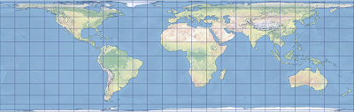

An example of the cylindrical equal area projection
The cylindrical equal area map projection centered on Greenwich is shown.
