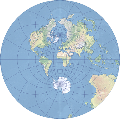

An example of the double stereographic projection
The double stereographic map projection centered on Greenwich is shown.
