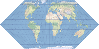

An example of the Eckert II projection
The Eckert II equal-area projection centered on Greenwich is shown.

Eckert II is a pseudocylindric projection. The meridians are regularly distributed straight lines interrupted at the equator. The central meridian is a straight line, half the length of the projected equator. The parallels are unequally distributed straight lines, perpendicular to the central meridian. Their spacing decreases toward the poles. The poles are straight lines, half the length of the equator. The graticule is symmetric across the equator and the central meridian.
