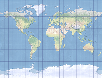

An example of the Gall stereographic projection
The Gall stereographic projection centered on Greenwich is shown.

Gall stereographic is a cylindric projection. The meridians are equally spaced straight lines. The parallels and both poles are straight lines, perpendicular to meridians and the same length as the projected equator. The spacing between the parallels increases from the equator to the poles. The graticule is symmetric across the equator and the central meridian.
