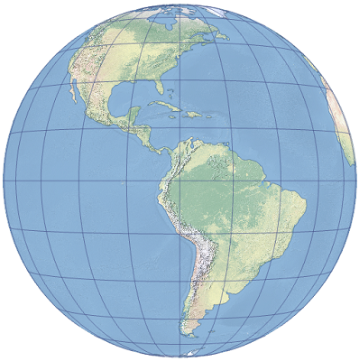

An example of the geostationary satellite projection
The geostationary satellite projection centered on 65° west is shown.

Graticule
Geostationary satellite is an azimuthal projection. It displays less than one hemisphere. The equator is always a horizontal straight line in the middle of projection. The central meridian is straight line, perpendicular to the equator at the nadir of the satellite, which is the center of the projection. The other meridians are unequally spaced and concave toward the central meridian. The parallels are also unequally spaced, but concave toward the equator. The poles and the meridians 90° away from the central meridian are never displayed. The amount of the hemisphere displayed depends on the height parameter. The graticule is symmetric across the equator and the central meridian.
