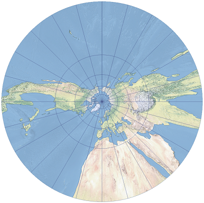

An example of the gnomonic azimuthal map projection
The gnomonic azimuthal map projection centered on the north pole is shown.

In the polar aspect, the meridians project as straight lines originating at the pole. Angles between the meridians are true. The parallels are unequally distributed concentric circles. Their spacing rapidly increases from the pole. The equator cannot be shown in a polar aspect.

Regardless of the aspect, all great circles project as straight lines.
