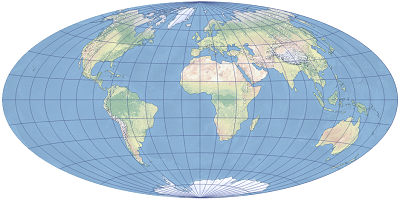

An example of the Hammer projection
The Hammer equal-area map projection is shown centered on Greenwich.

Hammer is a modified azimuthal projection. The central meridian is a straight line, half the length of the projected equator. The other meridians are complex curves, concave toward the central meridian and unequally spaced along the equator. The equator is a straight line. All other parallels are complex curves, concave toward the nearest pole and unequally spaced along the central meridian. The projection outline forms a shape of an ellipse. Poles are presented as points and they are co-vertices of the ellipse (on the minor axis). The graticule is symmetric across the equator and the central meridian.
