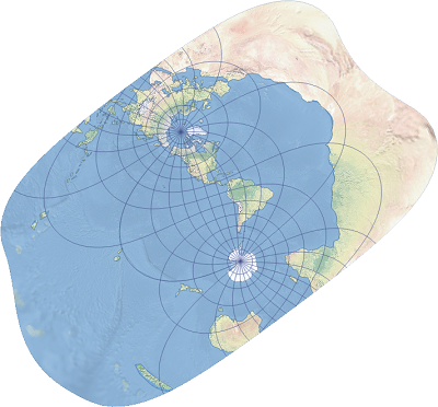

An example of the Hotine oblique Mercator projection
The Hotine oblique Mercator projection is shown.

Graticule
Hotine oblique Mercator is an oblique cylindric projection. In general, the meridians and parallels are projected as complex curves. Only two meridians, exactly 180 degrees apart, can be projected as straight lines, crossing the poles. Both poles are presented as points inside the projection outline.
