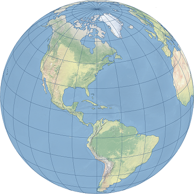

An example of the orthographic projection
The orthographic map projection is shown centered on the Caribbean.
