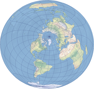

An example of the two-point equidistant projection
The two-point equidistant projection is shown centered on Redlands, California, United States, and Ljubljana, Slovenia.

Graticule
The two-point equidistant projection is a modified azimuthal projection. All the meridians and parallels project as complex curves. The poles are normally points within the map. The graticule is bounded by an ellipse, where the two focal points are on a semimajor axis and its eccentricity grows as the defining points are farther apart. There generally is no symmetry of the graticule unless the line connecting the two defining points lies on a meridian or the equator.
