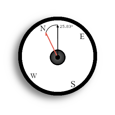

Magnetic variance
Magnetic variance refers to the angular distance between magnetic north and true north. A compass or other navigational equipment that relies on magnetic north must be calibrated to specify which direction is true north. Since magnetic variance changes over time and depending on the latitude and longitude, it is crucial that aeronautical charts show the correct magnetic variance to allow for the safe travel of aircraft.
A compass calibrated using magnetic variance
