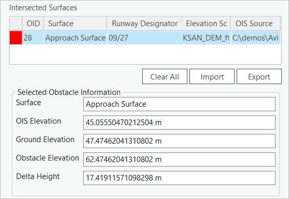

  11. Review the Intersected Surfaces table to identify which OIS surfaces are penetrated by the proposed obstacle.
    A red cell in the Intersected Surfaces table indicates that the proposed obstacle height penetrates the listed surface.
    Tip:
    Click a record in the Coordinate Points table to identify the intersected surfaces for that proposed obstacle.
  12. Review the Selected Obstacle Information table.
    Elevation values for OIS Elevation, Ground Elevation, and Obstacle Elevation are shown for the proposed obstacle. The Delta Height field displays the difference in elevation between the top of the obstacle and the OIS. Positive values indicate obstacle penetration of the OIS.
    Selected Obstacle and Intersected Surfaces information table with populated values
