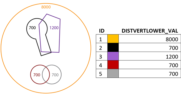

Airspace input
In the following image, five Airspace features of varying DISTVERTLOWER_VAL values are processed with the Label Airspaces parameter checked.
Five input Airspace features after the Generate Airspace Lines tool was run
Note:
The preference used in this example was simplified to only process one Airspace label, DISTVERTLOWER_VAL, which is an attribute in the input Airspace features. The Airspace labels configured in the preference will be used during processing to aggregate these Airspace attribute values and populate the AirspaceLine left and right labels with them.

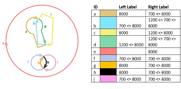

AirspaceLine intermediate results
While the tool is running, the polygons are planarized into lines so that intersecting line features are split into individual segments at each intersection. Nine intermediate AirspaceLine features are produced. The tool then labels the lines. Labeling is done by intersecting those lines with the original polygons to determine what is left or right of the line depending on the label information provided in the Target Airspace Lines Features parameter's LEFTLABEL_TXT and RIGHTLABEL_TXT fields.
Intermediate results showing nine Airspace features after tool processing
Note:
The intermediate results are for illustration only and won't directly appear in the AirspaceLine output.

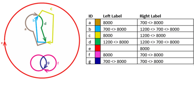

AirspaceLine final results
After labeling, the tool dissolves the intermediate lines by combining lines with common left and right labels. The final seven line features are then copied to the output feature class.
Seven line features processed and labeled
This allows you to form a continuous line with similar intersecting Airspace features, which can only be viewed with AirspaceLine features f and g in the example.
Note:
The AirspaceLine feature's left and right labels will also contain information from neighboring Airspace features.

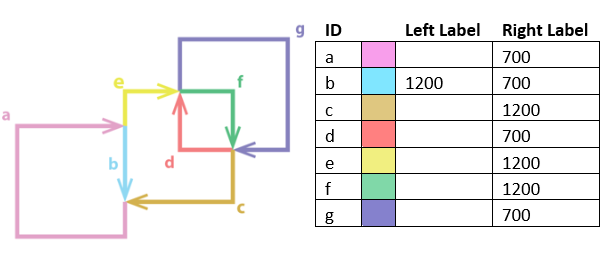

After labeling, the tool dissolves the intermediate lines by combining lines with common left and right labels. The final four line features are then copied to the output feature class. After the tool has finished, there is only one line , line I, that includes a left label because it was coincident with two Airspace features.
Four AirspaceLine features generated as a final output with the Label Airspace parameter unchecked
Left labels are only populated when a line shares an edge.
