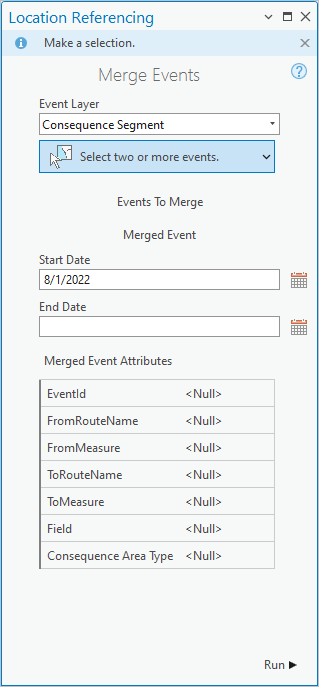

To merge events using the Merge Events pane, complete the following steps:
  1. Open a map in ArcGIS Pro and zoom to the location where you want to merge events.
  2. On the Location Referencing tab, and in the Events group, click Merge Events .
    The Merge Events pane appears.
    Merge Events pane before event selection

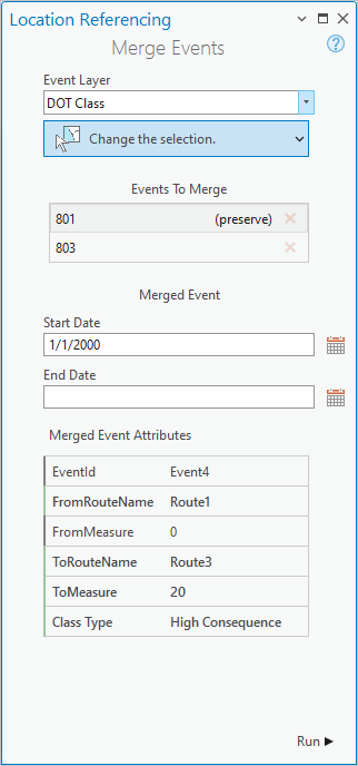

  3. Choose the event layer that has the events you want to merge in the Event Layer drop-down list.
    In the example below, DOT Class is the chosen event layer.
  4. Select the events on the map by drawing a bounding box.
    Tip:
    You can select events on the map using any of the selection tools. You can also select rows in the event layer attribute table while the Merge Events pane is active to populate the Events To Merge table.
    In either case, the events must belong to the same event layer specified in the Event Layer drop-down menu to populate the Events To Merge table.
    The selected event's Object ID is populated in the Events To Merge table in the order of route calibration.
    Merge Events pane after event features in the event layer are selected
  5. Optionally, change the dates in the Start Date and End Date text boxes.
    The default start date is the current date.
  6. Optionally, edit the attributes in the Merged Event Attributes section.
    LRS fields such as event ID and route ID are not editable.
    Note:
    Coded value, range domains, subtypes, and attribute rules are supported when configured for any field in the Merged Event Attributes section.
  7. Click Run to merge the events.
    A confirmation message appears at the top of the pane once the events are merged.
