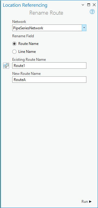

To rename a route using the Rename tool , complete the following steps:
  1. Open the map in an ArcGIS Pro project and navigate to the location where you want to rename a route.
  2. On the Location Referencing tab, in the Tools group, click Rename .
    The Rename Route pane appears.
    Rename Route pane
  3. Click the Network drop-down arrow, and choose the LRS Network that contains the route to rename.
    If the chosen LRS Network is a line network, the Rename Field section includes both the Route Name and Line Name buttons for route and line renaming options.
    To rename a line, follow the steps in the next section.
    Rename Route pane with a line network chosen
    If the chosen network is a nonline network, only the Existing Route Name and New Route Name text boxes appear.
  4. Specify the route to be renamed by doing one of the following:
    • Provide the route name in the Existing Route Name text box.
    • Click Choose route from map and click the route on the map to be renamed.
  5. Provide the new route name in the New Route Name text box.
  6. Click Run.

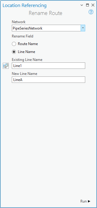

Rename a line in a line network
To rename a line using the Rename tool , complete the following steps:
  1. Open the map in an ArcGIS Pro project and navigate to the location where you want to rename a line.
    Rename Route pane
  3. Click the Network drop-down arrow, and choose the line network that contains the line to rename.
    The Rename Field section appears.
  4. Click Line Name in the Rename Field section.
    The Existing Line Name and New Line Name text boxes appear.
    Rename Route pane with line name options
  5. Specify the line to rename by doing one of the following:
    • Provide the line name in the Existing Line Name text box
    • Click Choose line from map and click a route on the line on the map.
  6. Provide the new line name in the New Line Name text box.
  7. Click Run.
