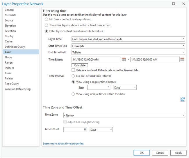

    • The tool populates the following parameters on the Time tab on the Layer Properties dialog box:
    1. Layer Time—Each feature has start and end time fields
    2. Start Time FieldFrom Date field of the LRS layer
    3. End Time FieldTo Date field of the LRS layer
    4. Time Extent—Calculated using the following formula considering all the LRS layers in the map:
      • From Date—Min (Earliest date - 20 years, Today's date - 20 years)
      • To Date—Max (Furthest date + 20 years, Today's date + 20 years)
