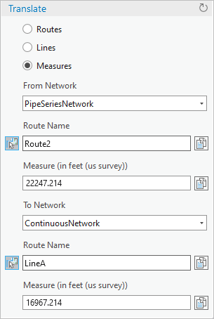

Translate measures scenario
In the following example, the Measures option is used to translate a measure on a route in an engineering network to a coincident measure on a derived route in a continuous network:
Translate measures from an engineering to a continuous network
The From Network value in this example is an engineering network while the To Network value is a continuous, derived network.
Choosing Route2 at measure 20 results in a translated measure of 15 on RouteD in the derived network.

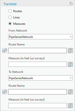

Translate measures
Complete the following steps to locate the provided measure on a coincident or intersecting route:
Tip:
You can also get the location of routes and measures using the Locate Route and Measures tool.
  1. Open the map that contains the network that is the source of the measure to translate.
  2. On the Location Referencing tab, in the Tools group, click Translate .
    The Translate dialog box appears with the Route button chosen by default.
  3. Click the Measures button.
    The measure-related fields appear on the Translate dialog box.
    Translate dialog box with measure-related fields
  4. Click the From Network drop-down arrow and choose the network that will provide the measure to translate.
  5. In the From Network section, choose the measure to translate by doing one of the following:
    • Click the Choose route from map button for Route Name.
    • Type the route name in the Route Name box.
    Note:
    After clicking the Choose route from map button , move the pointer over the route and click to select it.
    If only one applicable route exists at the edit location, it populates the text box when clicked. If multiple routes are applicable, the Select Route dialog box appears. Choose an applicable route from the applicable routes.
    The To Network measure is populated if the value is from the from network.
  6. If necessary, click the To Network drop-down arrow and choose the target network that contains the coincident measure.
    If the To Network value is changed after a From Network value is chosen, the selection is cleared.
    Translate dialog box with Measures chosen
  7. Optionally, click Copy to clipboard to save either measure for separate use.
