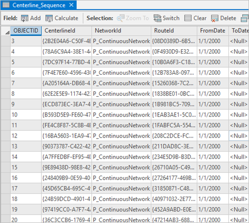

Centerline sequence table
The centerline sequence table is a cross-reference table for the many-to-many relationships between centerlines and routes. The table must include the CenterlineID field, the RouteID field, the NetworkID field, and FromDate and ToDate fields.
Centerline sequence table example
An example centerline sequence table schema is shown.
