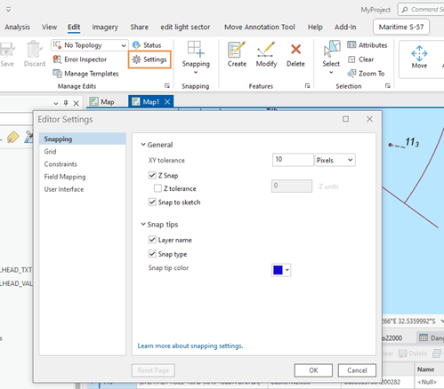

The Edit Light Sector tool can snap light sector limit lines and arcs to adjacent segments depending on the snapping tolerance. You can set the snapping tolerance in map units or pixels. The default snapping tolerance is 10 pixels. If the snapping tolerance is set to map units, the recommended value is 0.0005 map units. It is recommended that you set the map units in thousandths to avoid unwanted snapping to adjacent arcs.
Snapping section of the Editor Settings window

  3. Optionally, enable snapping and set the snapping tolerance.

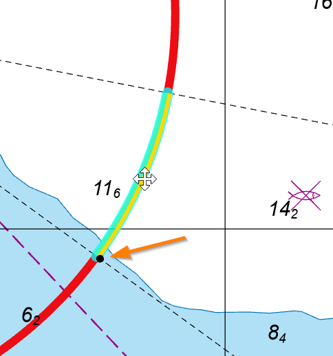

  10. Drag the selected features to extend or contract the light sectors.
    When the light sector arcs snap to adjacent arcs or limit line endpoints, a black dot appears to indicate coinciding features.
    Adjacent light arcs are snapped together.
