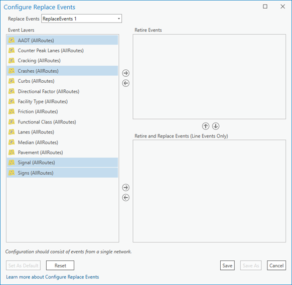

  1. In ArcGIS Pro, open the map that contains the feature service in which events will be retired or replaced.
  2. On the Location Referencing tab, in the Events group, click Configure Replacement .
    The Configure Replace Events dialog box appears.
    If no event replacement configuration exists, the Create New Replace Events dialog box appears on top of the Configure Replace Events dialog box where you can create a named configuration.
  3. Press the Shift key and click to select a range of events, or press the Ctrl key and click to select events out of order; then drag multiple line events from the Event Layers list to the Retire and Replace Events list.
    Choosing events for retirement
    You can also use the arrow buttons on the dialog box to move selected layers between the Event Layers list and other lists or to move line event layers up and down between the Retire Events and Retire and Replace Events lists.
    Tip:
    Click Reset to set the configuration to its original or last saved state.
    Event layers that remain in the Event Layers list are left as is when event replacement is run.
    Choosing events for retirement and replacement
  4. Press the Shift key and click to select a range of events, or press the Ctrl key and click to select events out of order; then drag multiple line events from the Event Layers list to the Retire and Replace Events list.
