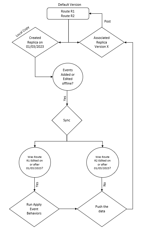

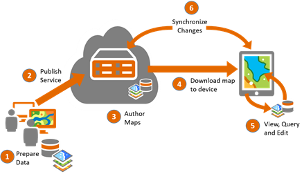

The following diagram shows the overall disconnected editing and sync workflow:
Overview of offline data collection and publishing workflow
Feature services must have the Replica Tracking and sync capabilities enabled, as well as the linear referencing and version management capabilities, to download a local copy (replica) of the data to a device. This allows field workers to collect and edit the data in the field even when they are disconnected from the network.
When a replica is downloaded to a device, an associated replica version is automatically created from the default version. The user can edit the local data and sync it with the associated replica version when connectivity is available. Syncing pushes the collected local data into the associated replica version, so it can be posted in ArcGIS Pro to the default version.
Note:
When a mobile worker syncs the data collected while offline, the Apply Event Behaviors tool runs automatically if the route was edited in the default version. If the route was not edited in the default version while data is collected in the offline map, the tool does not run.
Updates can be reviewed once they have been posted to the default version from the associated replica version.

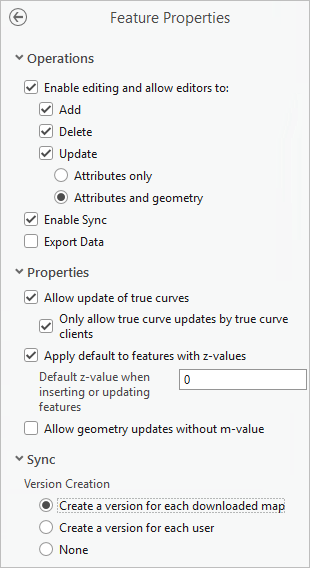

    1. Enable synchronization in the feature service's feature properties using the Enable sync check box.
    2. Check the Apply default to features with z-values check box and set the Default z-value when inserting or updating features value to 0.
    3. In the Sync section, for Version Creation, click Create a version for each downloaded map.
      Learn more about synchronizing with a replica version
      Feature Properties pane

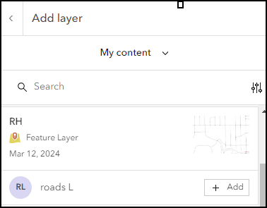

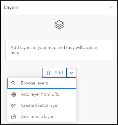

  3. Click the Add tab, choose Browse layers, and browse to the sync-enabled feature service that you published.
    Browse layers option
  4. Add the sync-enabled feature service to the web map by clicking + Add.

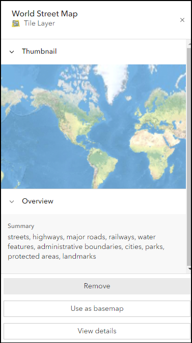

  5. Click Use as basemap to add a basemap that is enabled for offline use to the web map.
    Add a basemap

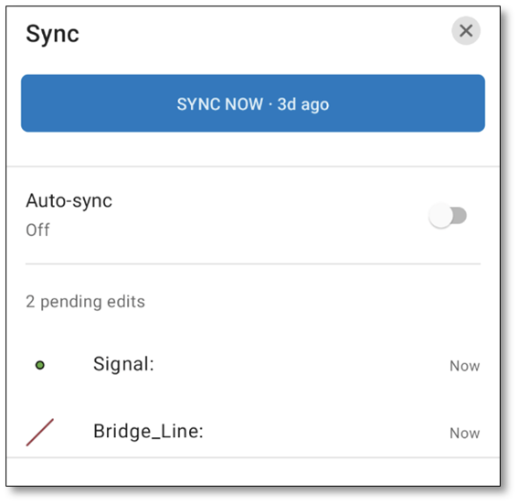

  1. Once you have regained network connectivity, tap the Maps Overflow menu.
    The offline edits performed appear as a list below the Auto-sync option. You can review the edits before syncing them with the server.
