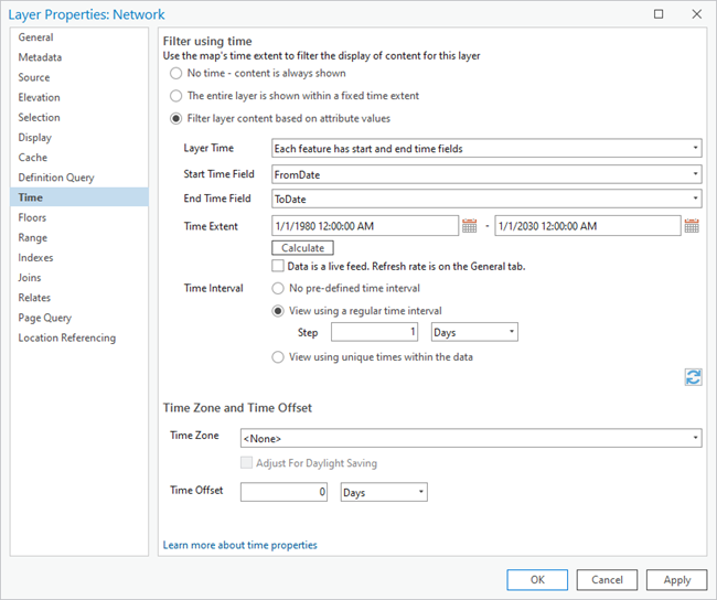

  3. Double-click the layer in the Contents pane to open the Layer Properties dialog box.
  4. Click the Time tab.
  5. Choose Filter layer content based on attribute values.
  6. Click the Layer Time drop-down arrow, and choose Each feature has start and end time fields.
  7. Set the Start Time Field value to the corresponding field in the layer that contains the starting date.
  8. Set the End Time Field value to the corresponding field in the layer that contains the ending date.
  9. Set the Time Extent value of the data to the date range on the data.
  10. Set Time Zone to the default value.

  3. On the Location Referencing tab, in the Tools group, click Enable Time .
    Time is enabled only for the LRS layers in the map as follows:
    • Time is only enabled for network, event, intersection, and calibration point layers in the map.
    • Time is not enabled for centerlines, redline layers, or tables in the map.
    • The tool populates the following parameters on the Time tab on the Layer Properties dialog box:
    1. Layer Time—Each feature has start and end time fields
    2. Start Time FieldFrom Date field of the LRS layer
    3. End Time FieldTo Date field of the LRS layer
    4. Time Extent—Calculated using the following formula considering all the LRS layers in the map:
      • From Date—Min (Earliest date - 20 years, Today's date - 20 years)
      • To Date—Max (Furthest date + 20 years, Today's date + 20 years)
