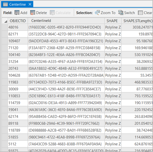

Centerline feature class
The centerline feature class is the geometry source from which routes are created. The table must include the CenterlineID field, the RouteID field, the NetworkID field, and FromDate and ToDate fields. The centerline feature class can be given a name that is appropriate to your business, but you may have only one centerline feature class per LRS.
Centerline feature class schema
An example centerline feature class schema is shown.

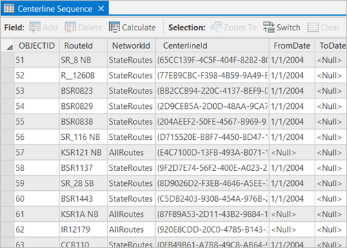

Centerline sequence table
The centerline sequence table is a cross-reference table for the many-to-many relationships between centerlines and routes. The table must include the CenterlineID field, the RouteID field, the LRSNetworkID field, and FromDate and ToDate fields.
Centerline sequence table example
An example centerline sequence table schema is shown.
