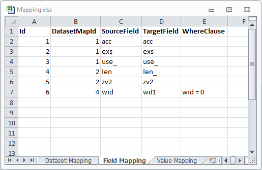

Field Mapping worksheet
On the Field Mapping worksheet, you can specify the fields in the source tables that need to be mapped to the target tables. This can be configured when the name of the field in the source does not match the target. For instance, the name of the length field could be "len_" in the source and "len" in the target. There could also be more obvious differences in field names, such as the name field is "NAM" in one workspace and "NAM1" in the other workspace. On this table, you need to provide an ID number for the table in the dataset, which can be found in the Id column on the Dataset Mapping table.
Note:
The SourceField and TargetField values are case sensitive and must match exactly when it comes to mapping. For example, RoadL and roadl would be treated as different fields.
A Field Mapping table example
Columns that must be on the Field Mapping worksheet are described in the following table:
FieldMapping fields
Field
Description
Id
A unique identification number that is automatically generated by the database. This identifier is used to reference the field mapping in the ValueMapping table.
DatasetMapId
A reference to the dataset mapping record as defined by the Id field in the DatasetMapping table.
SourceField
The name of the field in the source schema.
TargetField
The name of the field in the target schema.
WhereClause
Conditionally map a source field to a target field if the specified WHERE clause is satisfied. The WHERE clause is applied to the source dataset.

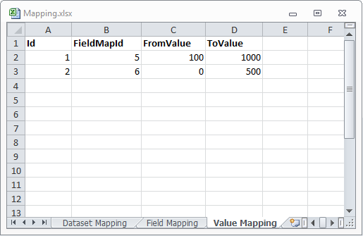

Value Mapping worksheet
With the Value Mapping worksheet, you can override values contained in a source field that would not be considered valid in the target field. For instance, you can replace all occurrences of the value "OPR" with "Operational". The FieldMapId value corresponds to the Id column on the Field Mapping table.
A Value Mapping table example
Columns that must be on the Value Mapping worksheet are described in the following table:
ValueMapping fields
Field
Description
Id
FieldMappingId
The related field map identifier. This value corresponds to the Id field in the FieldMapping table.
FromValue
The source value to be overwritten.
ToValue
The value to map to.
