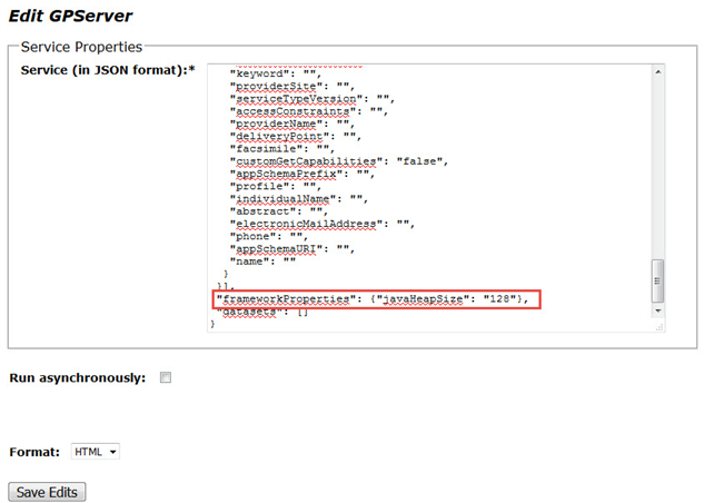

Change the heap size
The heap size setting controls the maximum file size that can be provided from the client . It can be set at two levels: server or service.
Changing the heap size at the service level provides better performance than changing the heap size from the server level. At ArcGIS Server 10.7 and later, the heap size can be set at the service level. The default size for each service is 64 MB. If you have an input file or feature class larger than the default size, change the service heap size as follows:
  1. From a web browser, browse to https://machine.domain.com/webadaptor/admin/login.
  2. Sign in to the ArcGIS Server Administrator Directory with an administrator account.
  3. Click the Resources: Services link to see a new page that shows all the published services.
  4. Click the service with the heap size you want to modify, and open the page with all the service properties.
  5. On the service properties page, click the frameworkProperties link to see the page with editable service properties in JSON format.
    An example of service properties in JSON format
  6. If javaHeapSize is not listed in the service properties, add the {"javaHeapSize":"128"} property to the JSON. If javaHeapSize is included, increase the value to the appropriate amount.
  7. Click Save Edits to save and finish editing.
