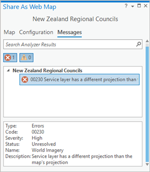

When you click Analyze in a packaging or sharing pane, a Messages tab appears at the top of the pane and displays errors and warnings.
Analyzer error message in the Share As Web Map pane
The map cannot be shared because it contains a service layer (typically a basemap) in a different projection than the map’s projection.
When you click a message, the message is selected and a box at the bottom of the pane gives additional information:
Category
Description
Type
The message type: either an error or a warning.
Code
The unique identifier of the message.
Severity
The impact on the sharing process or resource performance.
Status
An indicator of whether the problem has been resolved.
Name
The name of the layer or map associated with the message.
Description
A short description of the message.

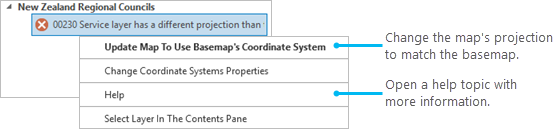

To resolve an analyzer error or warning, hover over the message and click the Options button that appears. (Alternatively, right-click the message.) A context menu provides a link to a help topic that describes the problem and lists available solutions. The context menu also includes commands that address the problem directly. These commands are useful if you are familiar with the problem. A bold-faced command represents the recommended or typical solution. If no single solution is recommended, the help link is bold-faced instead.
Analyzer message context menu
In this example, clicking the bold-faced command resolves the problem immediately. In other cases, the command may open a dialog box or pane where you take further action.
If you double-click an analyzer message without opening the context menu, the bold-faced action is executed automatically.
