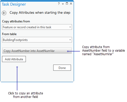

Copy attributes when starting the step
A task can copy attributes when a step starts. For example, copy and store the attributes of the footprint created in an earlier step and use them to calculate the fields of other building footprints created in the step.
Copy attributes before step starts

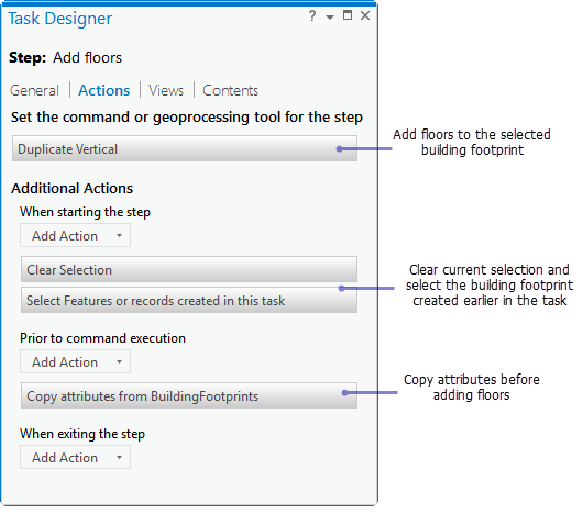

Copy attributes before command run
A task can copy attributes after the step has started but before the step command runs. For example, when the step starts, clear the current selection and select the building footprint that was created earlier in the task. Before the step command runs, copy and store the attributes from the selected building footprint.
Copy attributes before command runs

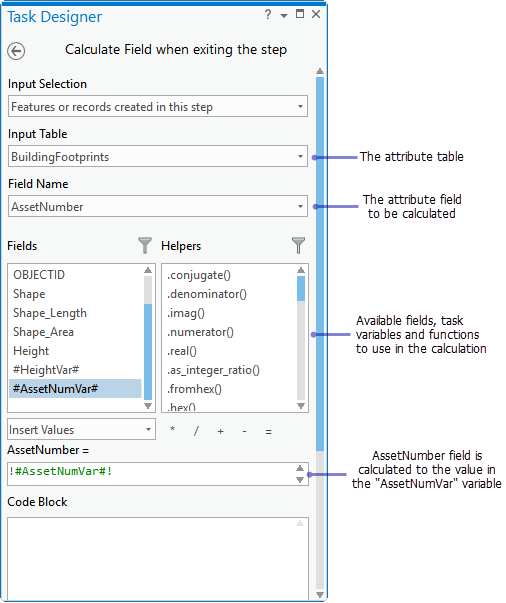

Copy attributes when exiting the step
A task can copy feature attributes when the step completes, such as in the following workflow:
  1. The first step runs the Create command that is used to create a building footprint.
  2. The second step opens the Attribute window, and the task user enters a new attribute in the AssetNumber field. The attribute value is copied and saved to a task variable.
  3. The third step runs the Duplicate Vertical command that adds floors to the building footprint. At the end of this step, the AssetNumber field of the new floors is calculated with the saved attribute value entered in the previous step.

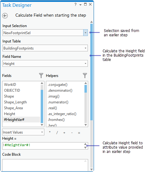

Calculate fields when starting the step
A task can calculate attribute fields when a step starts. For example, when the step starts, calculate the attribute field of a saved selection using an attribute value provided by the user in the previous step.
Calculate field
Calculate field

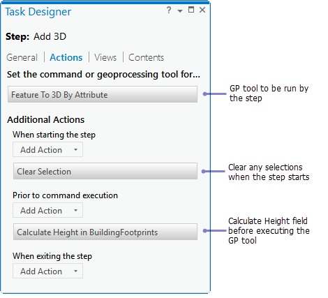

A task can calculate attribute fields after the step has started but before the step command runs. For example, when the step starts, clear the currently selected features. Before the step runs a command, calculate the attribute field of features in a previously saved selection. The step runs a geoprocessing tool that will use the features in the saved selection.
Calculate field before command run
Calculate fields when exiting the step
A task can calculate attributes when the step completes. For example, when the step completes, the field calculator is used to calculate attribute fields of the features created in the step.
