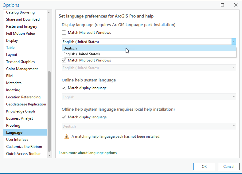

If you deploy a globalized add-in that contains multiple languages, ArcGIS Pro utilizes the language matching the Microsoft Windows setting and if there is no matching language in the add-in, the system reverts to the default resources. For example, if the add-in has these translations: Resources.resx (default translation) and Resources.de.resx (German translation), Resources.de.resx is utilized by Windows installations using the German language preference; whereas, all other Windows language configurations utilize the default translation, Resources.resx. ArcGIS Pro also has an overwrite option that allows changing the default language for ArcGIS Pro:
