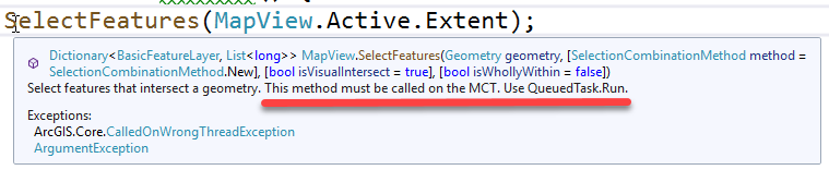

The majority of methods in the Pro API are synchronous and most all of the Pro synchronous methods require that they are run on the special Pro worker thread called the MCT. Synchronous methods that require the Pro worker thread are marked, in Intellisense, and the API reference, with "This method must be called on the MCT. Use QueuedTask.Run".
This tells the developer that the method must be executed (within an operation) within the context of a QueuedTask.Run. The QueuedTask.Run (and BackgroundTask.Run) returns a task to the caller when it is invoked that can be awaited while it completes.

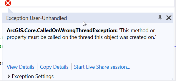

The initial mistake add-in developers can make when first working with the Pro API is to attempt to call synchronous methods directly in their add-in logic without wrapping them in a QueuedTask.Run. This will result in a ArcGIS.Core.CalledOnWrongThreadException exception* when the first API method that requires the MCT is called. This error is easily fixed by wrapping the appropriate methods in a QueuedTask.Run which is the subject of the next section.
* It is not intended that the CalledOnWrongThreadException occur in production code. The exception is provided as a debugging aid to inform developers that they are using the wrong thread to invoke the method. It is assumed that this condition would be fixed in the normal course of development.

We will use the following example workflow to illustrate the use of QueuedTask.Run. We assume an add-in developer has implemented the following code to select all selectable features within the current map extent whenever the containing 'SelectFeaturesButton' is clicked:
///<summary>Select all visible and selectable features within the "middle" of
///the current view extent</summary>
internal class SelectFeaturesButton : Button {
  protected override void OnClick() {
     Envelope selExtent = null;
     if (MapView.Active.ViewingMode == ArcGIS.Core.CIM.MapViewingMode.Map) {
        var extent = MapView.Active.Extent;
        selExtent = extent.Expand(-0.25, -0.25, true);
        MapView.Active.SelectFeatures(selExtent);
     else if (MapView.Active.ViewingMode == ArcGIS.Core.CIM.MapViewingMode.SceneGlobal ||
      MapView.Active.ViewingMode == ArcGIS.Core.CIM.MapViewingMode.SceneLocal) {
        //get the extent in pixels
        var sz = MapView.Active.GetViewSize();
        var builder = new EnvelopeBuilderEx() {
            XMin = 0,
            YMin = sz.Height,
            XMax = sz.Width,
            YMax = 0
        selExtent = builder.ToGeometry().Expand(-0.25, -0.25, true);
When the add-in developer does an initial debug of the code, the developer immediately gets a CalledOnWrongThreadException exception thrown:
On examination of the code, we notice that the developer forgot to wrap his or her add-in code in a QueuedTask. Therefore the add-in is (accidentally) attempting to execute all of the Pro API methods on the UI thread which causes the exception to be thrown. MapView.Active.SelectFeatures requires the use of the MCT and must be invoked within a QueuedTask.Run. Executing MapView.Active.SelectFeatures on the UI thread will throw a CalledOnWrongThreadException.
To fix this oversight, the developer add-in developer changes his or her code to use a QueuedTask.Run for all method calls that require it, wrapping each respective call in its own lambda:
